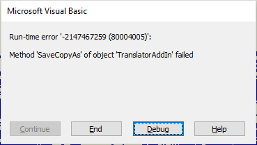

One other thing.  I get the following error when trying to save directly to my C drive:error.PNG
I assume that's because you need administrator permission to save files there.  This was just for testing purposes and the final file location where I'll be exporting these files is not administrator protected.  I can copy files directly to my C drive, but I get a pop-up message asking for permission before proceeding.  I am worried that I may need to export files to a folder with administrator restriction at some point.  Do you know a way to allow Inventor to export to these file locations using this method?  It's not mission-critical, but I figured I'd ask in case it becomes important later on down the line.

If it's something to do with folder permissions or admin privileges, then Inventor or iLogic can't help with that, you'll have to go to your IT admin for help with that.  You should be running Inventor with admin privileges already so the software doesn't get limited.  Have you tried directing the save to another folder such as your desktop or documents?

If it's exporting correctly to a network drive, then it is IT limiting your file writing capabilities for security purposes, not a problem with the Inventor Add-In.  Saving directly in the root of the C drive is usually locked by IT since that's how malware and other security flaws can get into the system.
