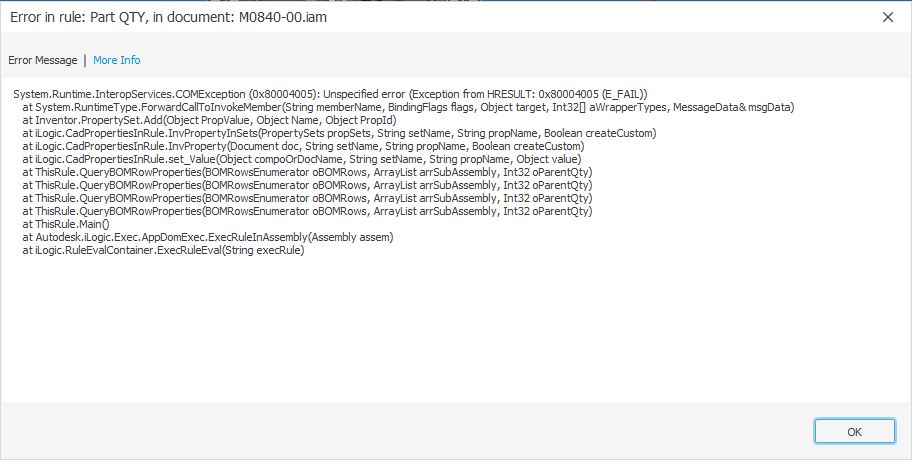

Hello Autodesk community!
does anyone know how to get the total number of a part from a top assembly down to a drawing?
I already have  a solution to the question. BUT, i cannot force inventor to count sub-assemblies. any help would be amazing.
With kind regards, Mikael Nanke

Message 3 of 36
Hello there jddickson.
thank you for the reply.
The overall problem is how the production function at my work and they need it, so i'm just simply following orders...
but i found a solution and would like to share it!
This code take the total quantity of a part and put it on the part as a custom parameter, so when i create a drawing, it state how many they need to produce of the given part.

Message 6 of 36
b.mccarthy
Thank you for this, however, the routine has decided not to play nicely....
I made one change to the code from:
   Dim Qty As String = oBOMRowPO.TotalQuantity
  to:
   Dim Qty As String = oBOMRowPO.ItemQuantity
The routine was running perfectly for about an hour after this change, and then started throwing this error:
Error Message:
   Error in rule: AssyCount, in document: CX-A-001968.iam
   The parameter is incorrect. (Exception from HRESULT: 0x80070057 (E_INVALIDARG))
More Info:
System.ArgumentException: The parameter is incorrect. (Exception from HRESULT: 0x80070057 (E_INVALIDARG))
   at System.RuntimeType.ForwardCallToInvokeMember(String memberName, BindingFlags flags, Object target, Int32[] aWrapperTypes, MessageData& msgData)
   at Inventor.BOMViews.get_Item(Object Index)
   at LmiRuleScript.Main()
   at Autodesk.iLogic.Exec.AppDomExec.ExecRuleInAssembly(Assembly assem)

This rule was working great so far.
Today I am getting an attached error.
Can anyone help me understand what's going on?
Thanks in advance.
Regards
Parag
Message 16 of 36
A.Acheson
Can you place a message box at various points along the code especially at entrance to sub routine to check how far along it gets and where it may stop.
Regards
Alan
Message 17 of 36
P_Korgaonkar
Thank you for your suggestion.
I dont know how to do it, I have just copied this code and used it.
Can you help?
Update this code with message boxes, and share it here if possible. I can test and give the result ASAP..
Thank you.
Message 18 of 36
A.Acheson
Can you check if the rule was run in the master level of detail?
Here is a snippet to paste in where indicate on the picture below. You can use this to  verify the rule is outputting qty values.
Logger.Info(Qty, "Progress Check")
You can place a message box  in the rule to indicate how far the rule gets. If you get an error before you reach the message box the error has then occurred before the message box.
MessageBox.Show("Message", "Title")

Message 19 of 36
P_Korgaonkar
Thank you A.Acheson
I tried as you suggested.
I have checked all assemblies are in Master representation.
Then I have added the snippet and message box where you suggested.
I got the Message box and had click OK 140 times first time I ran the rule, but this number kept changing every time I ran the rule again.
Rule ran and did not get an error at the end, but assembly quantity did not update.
All part quantities update to the correct number, but some sub assemblies don't.
If I delete custom property from the sub assembly and run the rule again, the property is not created again, meaning the rule does not work on sub assembly.
The Log shows INFO number every time I click OK in the message box..
Just to let you know this rule was working on the same Assembly few weeks back, the earlier models from the backup work, but after changes done in last couple of weeks it has stopped working. I am not able to pin point what changes made this not to work.
If you an advise further steps it will be greatly appreciated.
