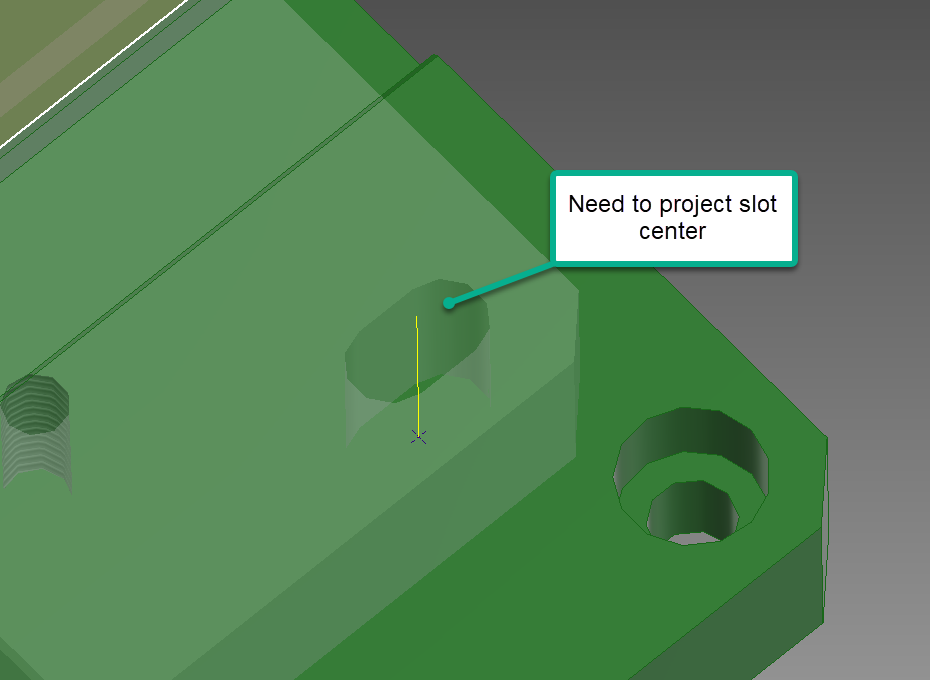

I am trying to project center of hole features to another part with VBA. I was able to do it, but we also use extruded slots. I was able to project the holes using the hole center point property. Like wise is there any way to project the extruded slot center. I used this code from API help and modified for projecting hole centers.
Thanks in Advance.
Anyone have ideas about this.
