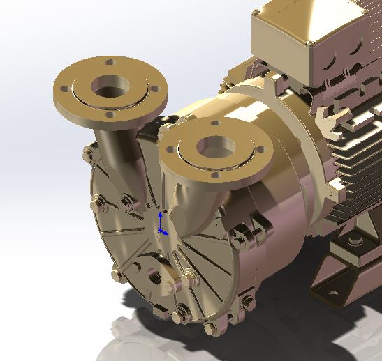

I am trying to open one solidworks model in inventor. Actual model is made using surfaces. When i am trying to open it inventor it appears as transparent surfaces. Please Refer the Images attached. I want the model in inventor same as solidworks. Please provide a solution.

dear sir  in prvious discussion you guys shared macro for copy properties to inventor ,, I can extract only summary and custom only ....configration specfic is not able to extract .. PLEASE LOOK AT  below image refrence

Message 5 of 8
lohithna
Message 6 of 8
YuhanZhang
Hi Lohithna,
The macros I shared to the customer are not used to import the properties but just do batch importing and change the color(translucent of surfaces). Currently we don't have Inventor API to specify which properties to import for Solidworks files, there is a .XML file(C:\Users\Public\Documents\Autodesk\Inventor 2018\Design Data\Import Properties\PropertyMap_SW.xml) used to map the Solidworks and Inventor properties that I think you can try to edit it to import some Solidworks properties or use below dialog to map the properties, but it only works for standard properties, so if you want to import the Configuration specific properties to Inventor files you can log a wishlist to IdeaStation. Hope this explains.
