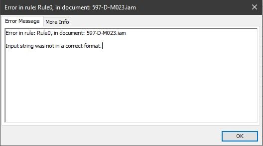

When I try to run it from a drawing, I get this error:
I saw "Inventor.AssemblyDocument" and thought maybe I should run it from the assembly level.
When I try to run it from the drawing's assembly, it seems to get further -- the MRP.xlsx file opens before I get this error:
Could this be because I'm using Inventor Pro 2018?
Message 4 of 24
JelteDeJong
i was expecting that you wanted to run this from an assembly. Anyway you managed to figure out that the rule is supposed to be run from an assembly.
I think i spotted the problem in the rule. (i tested it only on an assembly with only parts.) Try to replace the line:
Dim def As PartComponentDefinition = bomRow.ComponentDefinitions.Item(1)
with
Dim def As ComponentDefinition = bomRow.ComponentDefinitions.Item(1)
let me know if that helpt.
Jelte de Jong
Blog: hjalte.nl - github.com

@JhoelForshav @claudio.ibarra @JelteDeJong
Hey everyone,
I know this forum is a bit old but I figured I should post anyways.
I am currently trying to get this to work in Inventor 2020 but the excel file has nothing but the titles in it. I know this was mentioned earlier in the post but I have used the most updated code here at the bottom of the page and tried everything I could find in this forum. I have also removed everything but one column of "values" and played with the code trying to get something to work. Yet, I got no where. Any help will be appreciated.
Message 19 of 24
A.Acheson
@bsnyderACLUW @JhoelForshav @claudio.ibarra @JelteDeJong
Just had a quick look at this. this export is very specific to the iproperty keyword in each part. If that iproperty is empty no BOM values  will be exported. Only the column titles will be created in the excel sheet. The below snippet controls this behavior.
Dim oBomView As BOMView = doc.ComponentDefinition.BOM.BOMViews.Item("Structured")
		Dim i As Integer = 2
		For Each bomRow As BOMRow In oBomView.BOMRows
			Dim def As ComponentDefinition = BOMRow.ComponentDefinitions.Item(1)
			Dim cDoc As Document = def.Document
			Dim Keywords As String = getIProperty(cDoc, "Inventor Summary Information", "Keywords")
			If (String.IsNullOrWhiteSpace(Keywords) = False) Then
				oList.Add(New ExcelRowObject(Keywords, BOMRow.ItemNumber, BOMRow.TotalQuantity, multiplyBy10(BOMRow.ItemNumber)))
			End If
		Next
 You will need to provide more details on what BOM values you want to export.  as your intended workflow could be very different to this one.
Hope this helps.
Regards
Alan
Message 20 of 24
bsnyderACLUW
@A.Acheson
Thanks for replying,
The items I want to export is the quantity, part number, description, and material.
I figured I could replace "Keywords" with "Material" or MaterialType" across the board as I don't need or use the Iproperty Keywords but I still don't get anything outputting to the excel sheet.  I don't know if if I have the right syntax but it does run without error.
EDIT:
I have also injected a numerical value into the Keywors Iproperty of all the parts in my assembly and ran the program in this forum but i still get no output.
