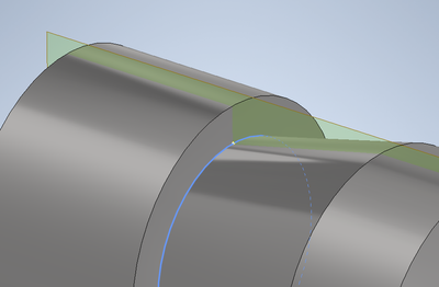

Curtis_Waguespack
@harvey_craig2RCUH , I would probably recommend just using some helper work points in this particular case, due to some of the reasons daltonNYAW9 alluded to.
Here you can use an origin plane and the edge to create the points, and then use those points as your intent by supplying lines such as this. Note I don't think Capture Current State will pick these up, but you can type them in as shown:
Dim WkPt1 = VIEW1.GetIntent("Work Point1")
