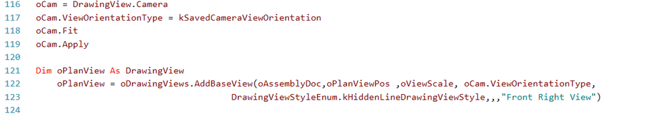

I have saved some camera view in an assembly. I now want to place a view on a drawing using one of these saved views.
I can get the standard views that i-logic allows you to access to work but cant figure out how to access these saved view.  here is what I would expect the code to be like, with  oCamera being a the saved camera view.

Hi @chris_davis.  Specifying the Camera object when using the DrawingViews.AddBaseView method is only allowed/used when you specified kArbitraryViewOrientation for the ViewOrientation.  Specifying the kSavedCameraViewOrientation variation is the way to go, but it may need to be done after the view has been placed, or you may need to include the 'last' optional input it is asking for named 'AdditionalOptions', which is a NameValueMap, in which you specify the name of that specific design view representation, and optionally whether or not it is 'associative', among other possible options.  If not including the 'AdditionalOptions', then you will need to edit the view after that line of code, to set the view's view representation (DrawingView.SetDesignViewRepresentation), then set its view orientation to that view representation's saved camera.
oCam = DrawingView.Camera
oCam.ViewOrientationType = kSavedCameraViewOrientation
oCam.Fit
oCam.Apply

Thank you for the response. I'm not understanding. Below is what I did and it gives me the attached error.  I'm not really a programmer so I'm struggling my way through this. The Idea is that using i-logic I can pick the view that best shows what I want and that view is to be placed on the drawing. Inventor gives me the front, back, left, right, etc. (.kTopViewOrientation, .kRightViewOrientation, .kLeftViewOrientation)
that I can place. I have no problem getting these to place on a drawing using i-logic. However, in some cases I want the front right, front Left
chris_davis_3-1746564530958.png and I have not found a way to get these views. So that is why I created the camera views under representations.

Now, on the coding side, the section of code I posted would go after your other line of code which places the view.  Then the first line of code that I posted would be getting the Camera object from the DrawingView object that you just placed an instance of, using that variable you used there (oPlanView) which is then representing that view (instead of just the 'DrawingView' Type specifier that was in my code example).  So, you would effectively be getting the Camera from the drawing view object that you just placed, then modifying the properties of that camera, which in turn effects what you see within the drawing view.
The other coding related thing I mentioned earlier was to just specify the first 5 inputs for that DrawingViews.AddBaseView method, without specifying a design view, or anything further than that.  Then after that line of code, when the view has already been created & placed, using that oPlanView variable, which now represents that newly created view, use its SetDesignViewRepresentation method to set which design view you want that view set to, and specify if it should be 'Associative'.  Then, in another line of code below that one, get that view's camera, and set those property values, so that the drawing view will be using that design view's own camera (as mentioned earlier)...if possible, due to the restrictions mentioned.

Thank you for the help. I was able to get my code to work. Attached is the order I placed the code to get it to run. I hope this will help others how are thing to do something similar.
Line 35 Places the view, (Step 1)
Then 41 Sets the view to "Front Right View" (Step 2)
Then 43 says its the camera view. (Step 3)
This follows the steps you showed in your response if doing it manually.
For some reason the oCam.Fit was giving me trouble, but it worked when I commented it out.
