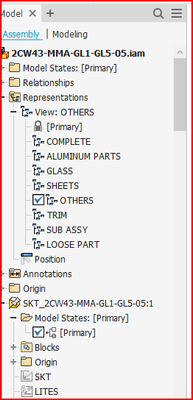

Hi everyone, I´m trying to turn on the visibility of a part sketch at the assembly level.  (Image)
The rule I created always overrides the visibility in the part, keeping it invisible at the assembly level.
I would appreciate it if someone could help me with this.

An important detail in this overall process that is easy to miss, or difficult to learn by experience, is the following behavior.  (touched upon in @hollypapp65 last reply, but expanded on here)
  • When setting a component occurrence (or multiple of them) to specific view representations, those settings are being recorded by the currently 'active' view representation within the active assembly itself.  So, your main/active assembly can have multiple view representations, and while each assembly view rep. is active, those settings (which view rep each top level component occurrence is set to) can be set differently, and will be shown that way.
  • So, when specifying which view reps you want the components to be set to, be mindful of which view rep is active in the current/active assembly also, because those choices/settings are being recorded by that specific one only.
  • If the 'active' view representation in the 'active' document is a 'Locked' one, like the 'Master'/'[Primary]' one, then your visibility changes (show/hide) and appearance/color related changes, will not be recorded by it.  So, make sure you have a custom one active before making those types of changes.
