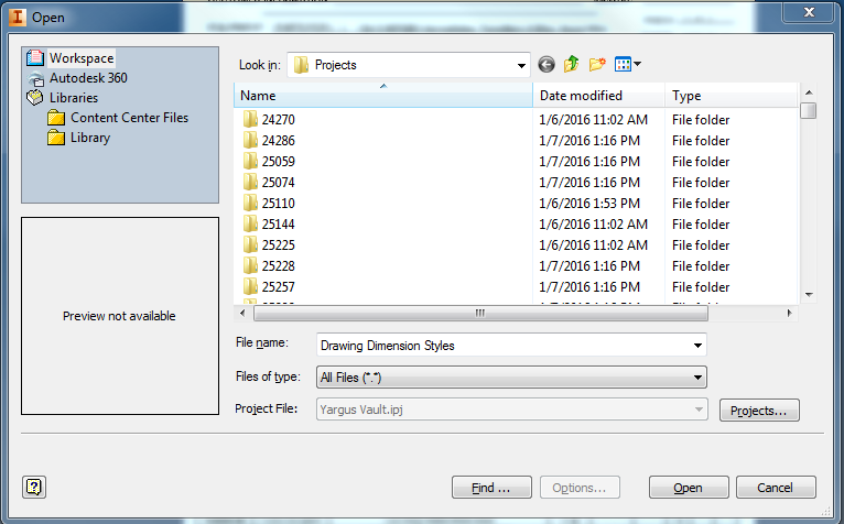

When we click the open button from inventor, quick launch buttons show up on the dialog box. One of them being a Vault button. Using iLogic, I am prompting the user to find a file through a dialog box, but the quick launch buttons aren't showing. Does anyone know why?
InventorVb.Application.CreateFileDialog(OpenDialog)
		OpenDialog.Filter = "Autodesk Inventor Drawings (*.idw)|*.idw"
		OpenDialog.ShowOpen()
		ThisApplication.Documents.Open(OpenDialog.FileName)
