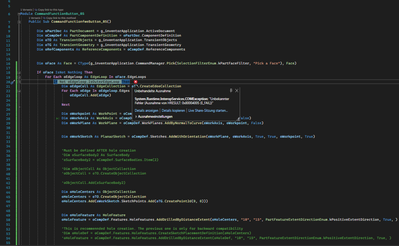

florian_wenzel
wrong Parameter.
unKnow Error:
and Without debugging, the it make the Hole in Body(2)
But give me Error:

florian_wenzel
still Error:
List(Of ObjectCollection)
Object not define
Message 9 of 10
Michael.Navara
You need to import namespace
Imports System.Collections.Generic
Message 10 of 10
florian_wenzel
ok, its Working 🙂
Thanks very much!
