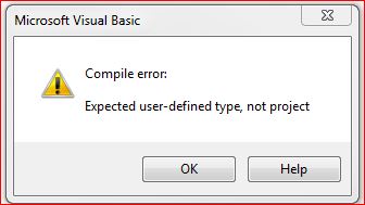

3. After i run macro got error
Is it there way to fix i beleive this is good add save a lot time.

It might be my error.... In the module,there should be a routine that calls the form it should look something like
Frm.DrawingViews Show
The name of that routine is what needs to be added to the menu button. I can't check right now because I'm not at a computer but as a guess, the routine you are calling is looking for form objects that are not there because the form isn't open. Also, this routine only works on drawing sheets.

put this in your MODULE (make sure it doesnt already exist)
Public Sub DrawingLabels()
frmDrawingViews.Show
End Sub
then in the customize user commands, add the macro called 'DrawingLabels' to the menu. This will call the form and open it. You are getting the error because you are not calling the correct routine. Objects are required from the form and becaise it is not loaded, you get errors.
Please try this and get back to me. I have tested this on 3 computers 🙂
