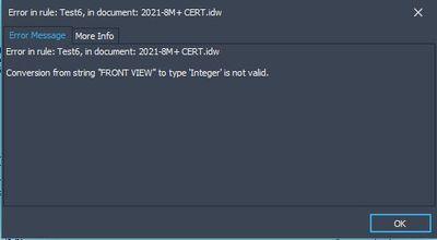

Returns the following:
WCrihfield
I've seen this before, for some reason it doesn't recognize the view name string in place of the index integer, as you can normally do.  So I switched setting the value of oView to a loop which searches all the views for one with that name, then checks to see that it found something afterwords.
