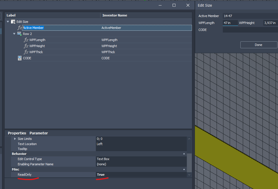

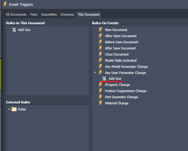

Hi @Frederick_Law . I changed your code a bit, form and added an event, I hope the result suits you. Tested in 14-42, 14-44, 14-46 and built 14-47 seems to work very well.

Changes as I made:
Sub Main()
	Dim oDoc As PartDocument = ThisDoc.Document
	Dim oCompDef As PartComponentDefinition = oDoc.ComponentDefinition
	Dim oModelStates As ModelStates
	Dim oModelState As ModelState
	Dim oModelStateOld As ModelState
	Dim oOccu As ComponentOccurrence
	Dim oOccuDef As ComponentDefinition
	Dim oOccuDoc As Document
	Dim OldState As String
	Dim newSize As Double = WPFLength
	If oCompDef.IsModelStateFactory Then
		oModelStateOld = oCompDef.ModelStates.ActiveModelState
		If oModelStateOld.Name <> "14-" & newSize Then
			Parameter("WPFLength") = oModelStateOld.Name.Remove(0, oModelStateOld.Name.IndexOf("-") + 1)
			Try
				oCompDef.ModelStates.Item("14-" & newSize).Activate()
			Catch
				oModelState = oCompDef.ModelStates.Add("14-" & newSize)
			End Try
			Parameter("ActiveMember") = "14-" & newSize
			Parameter("WPFLength") = newSize
			Parameter("d0") = WPFLength - 0.03 in
		End If
	End If
End Sub
Andrii Humeniuk - CAD Coordinator, Autodesk Certified Instructor
LinkedIn | My free Inventor Addin | My Repositories
Did you find this reply helpful ? If so please use the Accept as Solution/Like.
