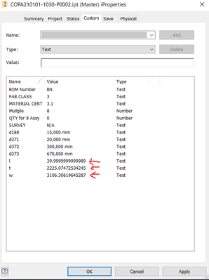

Hi, I facing some problems, I did manage to get the information that I want using code 1 as below

The problem is, it does not update my iproperties as shown below.
the value from the msg box for code 1 is already correct, only not updated to the iproperties. is the anywhere to solve these issues?

JelteDeJong
try this:
Public Sub Main()

syafiqfarhan
This code looks great and can update my properties. Thanks.
but one new problem happens, the value was not correct
is that possible to make it value without a decimal place? eg l = 40, t = 2225, w = 3106
JelteDeJong
try this:
