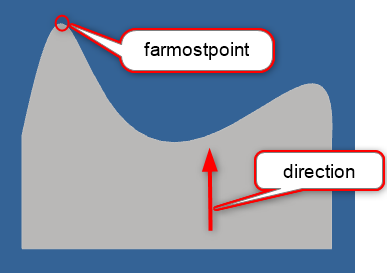

TONELLAL
All of this is very interesting ! I now have several methods and better understand how it works.
But there is a limitation for these methods : extrem edges of the torus must be circular. Or, at least, must have a center (in this case I'd consider that the torus length is the length between centers). What about a torus with notched ends, like this one :
The length should be the length of the "range torus". Tn this case, I need to get the Farmostpoint, but the direction should be a "circular vector", instead of a usual unit vector :
On a planar edge :
In the case of a torus :
I tried several approaches, but nothing very clear :
  • Get points on the edge, with Edge.Evaluator.GetPointAtParam(params, points). It seems there is always a point at the farmost point, but I don't understand why this should be always true :
  • Use these points to calculate "unfold edge", by a spline define like this (in transient geometry) :
 Once we have the plane curve, it is possible to obtain the farmost point (here at the left in yellow), then get back the corresponding parameter and use it to get the point on the edge using oEdge.Evaluator.GetPointatParam.
  • Use oEge.GetFirstDerivative
On planar curve, derivative (or second derivative) can be used for slope (or curvature. So I suppose it can be used on 3D curves too... But math classes are far away ^^
  • Get the BoudingBox of the edge, then use vectors by (torus center, Boundingbox center). This is the easiest way, but also the most approximative :
