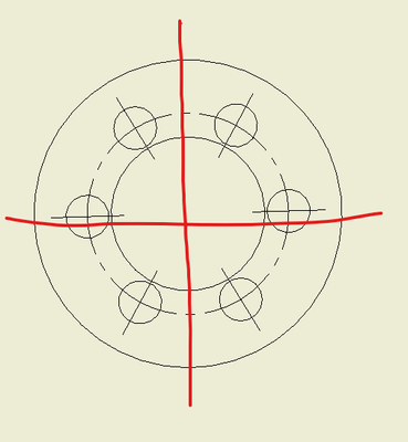

Could you please help with an iLogic rule for only the outside circle, as shown in the photo below?
Message 9 of 26
Curtis_Waguespack
@DIMCWPDR , you can right click on the outer circle and use Capture Current State as shown below, and then use the iLogic Centermark snippet to do this:
Message 10 of 26

I think I need help again with mig ilogic code. I need only the centermatks only as shown in the pic below:
But when i run the rule i get the centermark in all the holes.
Can you please tell me which the text i have to tuen off or remove?
Her is the rule:

Hi @DIMCWPDR.  As I mentioned in message 10 above, if you want to use the AutomatedCenterlineSettings for these types of tasks, then you would have to customize those settings according to the size of the feature you are targeting, and by what type of feature created it.  Review the following copy of your last code, and my comments on some of those lines.  If we know what type of feature created that largest round circular feature, then we can filter out all other types of features, leaving only that type of feature.  Also, your images do not indicate what size the largest circles are, or what size the smaller circles are, so only you would know that.  There are settings for minimum and maximum radius to be considered for getting things like centerlines and centermarks.  But we can not write those values in for you, because we can not tell now small to make the minimums, and how large to make the maximums.
Also note the changes I made to the 'If' statement just inside the loop of views.  It should now filter out any view set to that one specific view orientation, but when that one is encountered, it will now continue on to the next view, if any, instead of exiting out of the whole rule.  I also eliminated the last several lines, because they had no use anymore in this example.

Can I provide you with my .ipt and .idw files so you can take a look at them? The problem is that I have many gasket drawings like this for my project, and I need to automatically generate centerlines and centermarks as shown below
I only need this centerlins as following pic below
Message 19 of 26
