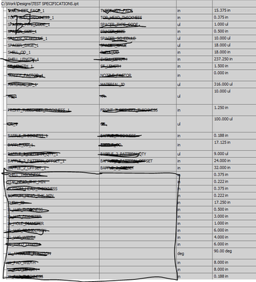

I have a code that will link parameters from a Source file .ipt to a Destination File .ipt or .iam. The issue with my code is that it brings in ALL the user parameters from the Source file even if they are not being used in the Destination File. I would like it if when linking the Source file and the Destination it only brings in the user parameters being linked between the two files. Can anyone tell me how to get the code to only bring in user parameters that are consumed by the Destination file or at the end of the code how to remove the unused user parameters.

How can the destination file already be 'using' any parameters that are about to be 'derived into' it from another file?  Without knowing how to answer that, we won't know which parameters to not include from the source file.  The basic Parameter object defined in the Inventor API does have a couple properties that you can inspect though.
Parameter.Dependents
Parameter.DrivenBy
Without seeing your original code, and which method(s) you are currently using for this task, not sure how we can suggest specific changes to it, to make it work the way you want.  When 'linking' parameters between Inventor documents, that is using the 'derive' process, and therefore will start with accessing the Parameters.DerivedParameterTables property value, which is the DerivedParameterTables collection object.  That gives us two 'Add' type methods (DerivedParameterTables.Add and DerivedParameterTables.Add2).  The original Add method only lets us specify the 'FullFileName' of the source file, while the second method gives us the additional ability to specify an ObjectCollection with Parameter objects in it that we want to 'Link'.  If that ObjectCollection is not provided, then the only way to control which ones will get 'Linked' is by marking each Parameter for export in 'Export Parameter column of the Parameters dialog, which is the same as setting the Parameter.ExposedAsProperty property's value to True.  And if the 'Link' has already been created, but you want/need to change which ones are included/Linked, then you can set the DerivedParameterTable.LinkedParameters property value with a different ObjectCollection of Parameters that you want to be Linked from the source.
