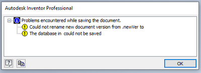

I've got a part W2400 that pushes iproperties to another part W2400_str by running the following ilogic code (that I found and adapted from these forums) with a "before save document" trigger.
The problem is I consistently get an error on 1st save and then if works on 2nd save (and when used in a larger assembly it disrupts the saving of the other unrelated parts on 1st save).
Any ideas on how to fix this or a better way to get the end result?
Dim str_part As String = ThisDoc.PathAndFileName(False) & "_str.ipt"
new_desc = iProperties.Value("Project", "Description")
new_part = iProperties.Value("Project", "Part Number")
Dim oDoc As Inventor.Document = ThisApplication.Documents.Open(str_part, False)
Dim oPropsets As PropertySets = oDoc.PropertySets
Dim oProject As PropertySet = oPropsets.Item("{32853F0F-3444-11D1-9E93-0060B03C1CA6}")
oProject("Description").Expression = new_desc
oProject("Part Number").Expression = new_part
oDoc.Save()
oDoc.Close()

I've tried your code but get the following error
Unspecified error (Exception from HRESULT: 0x80004005 (E_FAIL))
Also when I try my code with the PropID string changed with "Project" I get a different error
Invalid class string (Exception from HRESULT: 0x800401F3 (CO_E_CLASSSTRING))
I'm not sure how to get more useful debugging info.
I also noticed your changed .Expression with .Value, does that do anything?

peter.roman
The thing is both files always exist so the first check doesn't really do anything
If System.IO.File.Exists(str_part) = False Then
I think the issue lies with
oDoc.Save()
I don't seem to get the error if I remove this and just save manually.
I've updated my code as below, including some of your additions.
It checks if the straight part is open already (in the context of an assembly) and if not it opens it "visibly" (in it's own window; if it's already open I don't open a new window for it).
The iproperties get pushed to it.
Then I can save the assembly / now open part or if I try to close it I will now get a prompt to save (which I wouldn't get on closing without doing it this way).
