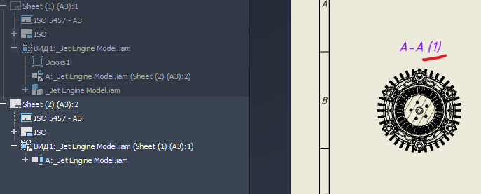

Hello everybody.
I want to get and edit the section label text on the drawings, but I can't find it in the API. All I know is that the object is "kGenericObject" (2130706445).
Вefore:
After:
Any help would be appreciated.

Hi @WCrihfield . Thank you for your reply. But this is somewhat not what I want. I will try to explain in more detail.
I have a section view and section mark on different sheets. But I need to add in the name of the type of section on which sheet it is located (I have already done this). And add in the designation of the section on which sheet the type of section is located.

Andrii_Humeniuk
Hello everyone.
I'm still struggling to solve this problem, but I think I've found what I need. It turns out that among the CommandNames there are some that, according to their description, look like editing text on a section mark.
DrawingViewEditTextOnDetialSectionAnnoCtxCmd Edit Text
DrawingViewEditTextOnFirstSectionAnnoCtxCmd Edit Text
DrawingViewEditTextOnSecondSectionAnnoCmd Edit Text
Unfortunately, in my case the commands don't work, maybe someone has an idea why?

jnowel
I tried the Control Definition above, but it only works when you select the specific Section Line Text/Label (not the Section Drawing View/ View.Label object)
I'm not sure how to access that "Text/Label" as it seems not available in the API.
A different approach that may achieve your desired outcome is to put a SketchedSymbol (with a Prompted Text) as a placeholder for the Sheet number where the Section View is located.
That SketchedSymbol need to be manually attached (via leader) though on the section line as I don't see a way to attach it via API
