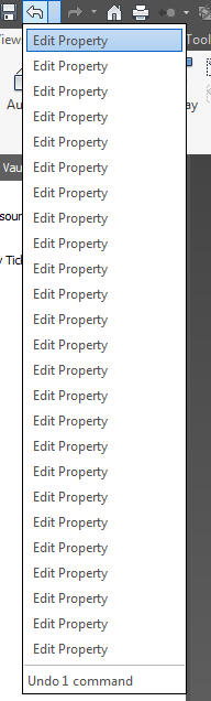

I know this is an older post.  But we have implemented some custom addin's (written in c#) which fire on document change event, ending in a lot of iproperty changes.  With this change our undo commands are pretty much nixed in that there are like 30 iproperty edits in the history tree before getting to the actual last step the user would have known they performed.  Is there a way to suppress or turn this off and then potentially back on during edits.  Attached is an example of what our undo history turned into.  It looks like autocad had something where you can disable undo from "recording" however I am fully aware that inventor is not autocad and autocad is not inventor.

DRoam
That's easily accomplished by wrapping all of your operations in a single Undo transaction. There are many ways to do that, but here's a pretty simple one:
Dim oDoc As Inventor.Document = ThisDoc.Document
Dim oTransaction As Inventor.Transaction = ThisApplication.TransactionManager.StartTransaction(oDoc,"Transaction Name")
Try
	'~~~~~YOUR CODE HERE~~~~~
Catch
	MessageBox.Show("An error occurred")
Finally
	oTransaction.End
End Try
You start a transaction (give it a name of your choosing), do all of your operations, and then end the transaction. You can wrap everything in a Try/Catch so the transaction will still be ended if any errors happen that aren't handled by "YOUR CODE".
