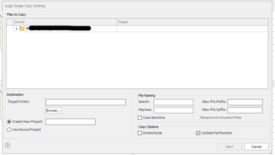

seems like you have an older version of Inventor.
Inventor 2023 (and onwards) have the "find and replace" function in the iLogic Design Copy.
maybe the Customized copy design tool here can be of use for you.
Betreff: Customized copy design - Autodesk Community - Inventor
(Disclaimer: i haven't tried it but here's how it look)

Perfect, I will go check with IT right now. (I am in 2022)
