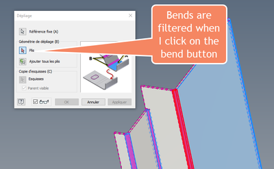

Is there a way to select a bend of a part like when using the unbend function with the pick function in PartDocument.
I can't find it in the Selection Filter Enumerator list.
I would like to be able to select bends with the pick function.

Hi @vpeuvion.  It is true that the SelectionFilterEnum does not contain a variation specifically for a Bend object or a BendFeature object.  The closest variation is the kPartFeatureFilter option.  What do you intend to do with the bend, once selected?  You may just have to use a secondary filter to avoid getting the wrong Type, or just loop through all bends, instead of using Pick function.

Hi @WCrihfield . Thank you for your reply.
Here's a simplified example of what I'm trying to do.
In this example, I select the reference face, the part is fully unfolded and then the part is refolded.
I wish I could select just one bend for refolding. The oBends objectCollection would only contain the selected bend.
Do I have to select a face that belongs to the bend and from there find the FlatBendResult?
