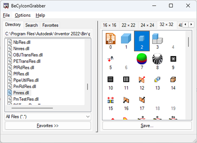

Does anybody know or have those .ipt, .iam icons or how to get them?

I believe you would first have to find/get the ControlDefinition using them.  Then use its ControlDefinition.LargeIcon and ControlDefinition.StandardIcon properties to access the 'IPictureDisp' object.  Your code should be 'referencing and importing' the "stdole" source, where the IPictureDisp Type is defied, and the System.Drawing source.  Then you would need to convert that data type to the System.Drawing.Image data type, using a custom Class that 'Inherits' from the System.Windows.Forms.AxHost Class, and contains methods for converting between the two data types.  Then save the Image out as a bmp or png type file.  Years ago, I used to use a VBA macro for this type of task, but it used resources and methods which may now be outdated.
AxHost.GetIPictureDispFromPicture
AxHost.GetPictureFromIPictureDisp
I believe the ControlDefinitions you may be interested in are the ones under the 'File' menu, and the 'New' sub category.  Those can be a bit odd to find.  I believe they are named:
"NewFileTemplate5" (presentation)
"NewFileTemplate4" (part)
"NewFileTemplate2" (drawing)
"NewFileTemplate1" (assembly)

I've gotten a component's icon from the native browser node definition of its model browser pane top node. The Icon property returns an IPictureDisp object which you can then use it's Handle to stream it to another type of image. I was creating a BitmapImage for use in WPF windows. I liked that it was an icon based on the document sub-type; weldment, sheet metal, etc.
BrowserPanes.GetNativeBrowserNodeDefinition Method
NativeBrowserNodeDefinition.Icon Property
Unfortunately for me the browser icon changed based on light or dark theme and I was trying to use them on a white background. I ended up screenshotting Windows Explorer to get the document icons. If you use a folder with a lot of Inventor documents in it you can catch it before they're replaced with thumbnails. You only get the style of icon Explorer uses, but that worked for me.  It's also nice to get the icons in different sizes. I tried to figure out what dll they're stored in, but I gave up looking after a while. @WCrihfield - I'll have to look into what you did. I never thought to do it that way.

@GosponZ
There’s a small application for extracting icons from .dll files. If you need a specific icon, download the app from GitHub. The application is called BeCyIconGrabberPortable. After selecting the .dll file, you can find the icon you’re interested in and save it.
I’ve also attached the Part and Assembly icons.
