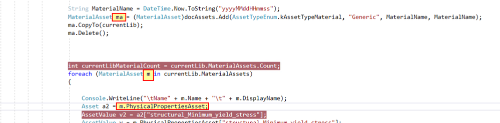

but physical asset it is not created. So when i try to get hold of physical assets, to update properties it throws error.
below is PhysicalPropertiesAsset quick watch & error screenshot

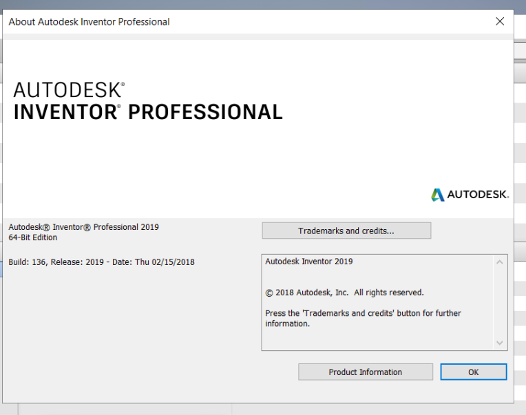

I am using inventor professional 2019 build 136.

I can see that you are defining your material asset with "ma" in your code, and when you are trying to get Physical properties to value you are using "m", I am not sure if that's causing the issue, but just seen it in the snapshots.

Missed to clarify about 'm' & 'ma'.
i create MaterialAsset 'ma' in current document. Then i copy it to custom material library and then loop through all materials with 'm' as iterator to access physical properties. Here is the snippet of that.

I am using 2019 and Build 330, and you are using Build 136, I can not say whether it is a bug in the programme in that specific build or not because I can not test it.
