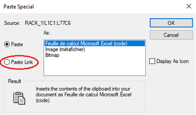

sgodonVEAP9
maybe a bit off topic but anyway to trigger "paste link" and "OK" after:
ThisApplication.CommandManager.ControlDefinitions.Item("AppPasteSpecialCmd").Execute
thanks!
Message 7 of 9
WCrihfield
Hi @sgodonVEAP9.  The only way I can think of to manipulate that dialog after executing the command would be to use System.Windows.Forms.SendKeys.SendWait() method, which could act similar to simulating keyboard key presses, which you could use to navigate around the dialog.  First, try to navigate around that dialog by using keyboard keys only.  Once you figure out the exact keyboard key routine that needs to happen, write that down, then use that SendKeys.SendWait method to simulate that routine after executing the command.  It is always risky to use, and should be a last resort though.

sgodonVEAP9
WCrihfield, that would be perfect but the code stops at this line:
so it doesn't continue to do the send keys 😞 do you know how to write that down? thanks!
Message 9 of 9
sgodonVEAP9
Here's the answer if it can help others:
Call ThisApplication.CommandManager.ControlDefinitions.Item("AppPasteSpecialCmd").Execute2(False)
SendKeys "{TAB}", True
SendKeys "{DOWN}", True
SendKeys "~", True
