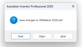

I have never seen a message like this before; when I click to save button from VBA IDE this message appears, even if I made a clean startup of Inventor..
or if I close Inventor without saving the default ivb I click to yes to the message box to prompt save ivb or not..  again the same message..

if ivb in shared location where multiple users have read write access. if anyone tries to save the ivb in vba ide. The above message will pop up
marcin_otręba
This mean that you do not have write permission for this file, it can be due fact that:
1. it is shared beetween users as @gopinathmY575P  mentioned - copy it locally, change it and copy it back to server,
2. but also if you work not in first instance of inventor - make sure you have open only one inventor instace,
3. or file has read-only property set to true - check file properties.
