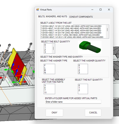

We are trying to create a VB.net form to integrate with iLogic rule.
Error code:  0X80131500

We can add in a Windows Form - but as soon as we add in the Inventor 2024 iLogic references the form will no longer load.
Unknown error.
After doing a rebuild and when we attempt to load the form we get the following error dialog
Can we no longer utilize Windows Forms with Inventor 2024?

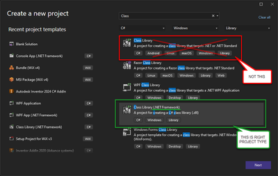

WinForms works well for me in Inv 2024.1
But the issue can be in target .NET version. You need to use .NET Framework 4.8 instead of .NET 5

Michael.Navara
If you have Inventor installed, you have installed .NET Framework 4.8 also. This si a mandatory component.
But you need to start (or modify existing) project in VS to use .NET Framework 4.8
Screen shot is from VS 2022 but in 2019 it is similar.
