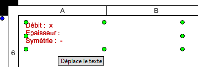

I want to copy a drawing note from one document to another. The problem is that the new drawing note has a different RangeBox size than the drawing note that was copied from.
I can't seem to resize it, this note contains parameters and when they are filled, the length of the line of text exceeds the maximum length and jumps to the line.
I tried with AddByRectangle and AddFitted but the RangeBox of the new drawing note is always minimized. I also tried with GetBoxData and PutBoxData but this gives me an error message and the RangeBox is always reduced to the minimum.
Does someone have an idea?

 Drawing note for reference :
Drawing note after copy :
Is it possible to change the size of the RangeBox?

Hi @vpeuvion.  That size difference thing is definitely a tough one to fix by code.  Manually, I often see similar notes where the apparent boundaries are way larger than the contents of the note, and one thing that often works to fix it (manually) is to edit it, add a space at the end of one of its lines, then delete that character again, then click OK.  That often causes the 'bounds' to auto-fit the contents, without having to drag corner nodes.  That reaction may just be a built-in supportive 'helper' that only happens when this is done manually.  But to test, you could try editing the contents of the note a second time, after its 'linked' values have been obtained/updated, just to see if that will fix its bounds, like the manual process does sometimes.
The alternative may be to use a SketchedSymbol, instead of a GeneralNote, where you would have access to the actual TextBox object, and its 'border geometry', so that you could control its size with sketch based constraints.

I did your test and if I edit the content a second time when the linked values are filled, the size updates fine. Unfortunately I don't know when these values are filled and I can't re-edit the content with each change.
But your answer gave me another idea, when I insert the text into the note, I add an extra line which contains a space string and the drawing note is sized according to the size of this string. It's not a very clean way of doing things but it solves my problem.
oDrawingNote.RangeBox is read-only, which is probably why we cannot resize it after creation.
Dim oNewNote As DrawingNote = oSheet.DrawingNotes.GeneralNotes.AddFitted(oNote.Position, oNote.FormattedText & Chr(13) & "                                                    ")
