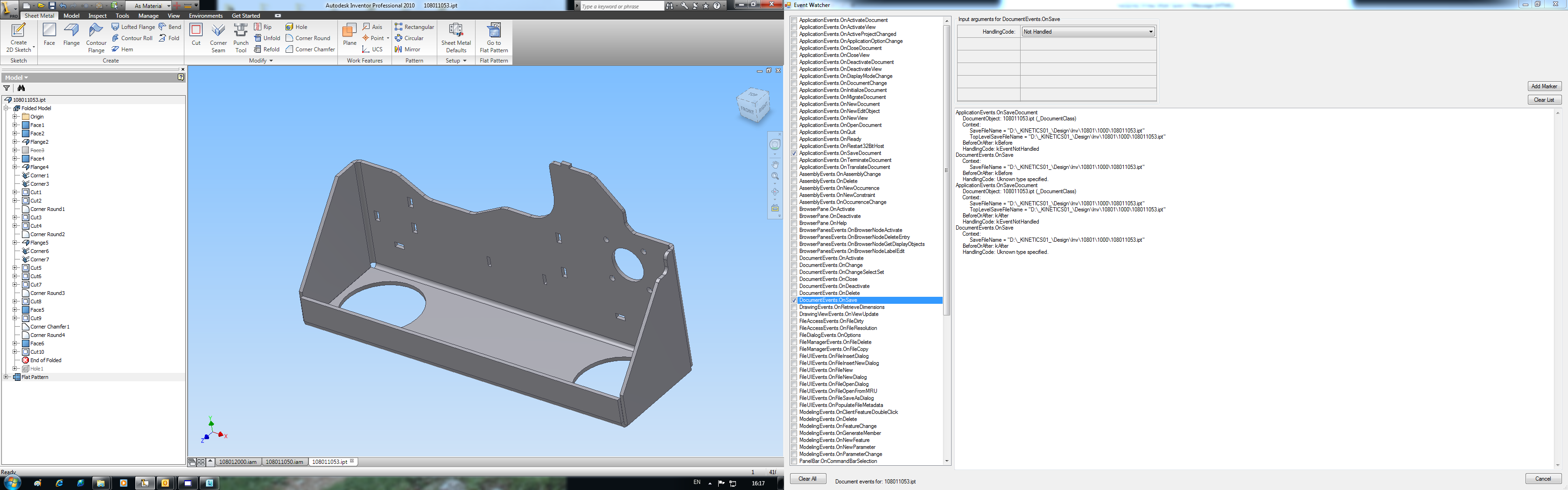

Hello ,
Inventor has an event viewer. There I saw that sometime its is not saving the files.
It happens randomly in parts or assy. Is it possible to get a notification when it is not saving so at least the
user knows when he has the problem? maybe something in ilogic and the rule will notify if it cant save.
Any idea will be much appreciated.
Dan

Dan_Margulius
Hi
Maybe it is not saving because some add in. We have EPDM add in on Inventor.
We dont know why Inv is not saving. The guys from support also can't help.
I am attaching more pictures, maybe someone here may save us.
Dan

adam.nagy
Autodesk Support
Autodesk Support
It's not clear from here if it's only the OnSave event not firing or Inventor actually not saving.
Another thing is that you could unload all the AddIn's and see if that helps.
Cheers,

Dan_Margulius
The users say that Inventor is not saving the part or assy.
They found out after a day or two...
With the event viewer we started to see that actually the SAVE is not working.
Thank you very much,
Dan
