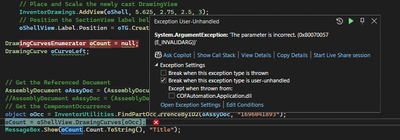

@varad.keshatwar I have found another unexpected issue.
I have been trying to find all the drawings curves on a particular view for a specific ComponentOccurrence. I keep getting the following error
It seems as if it matters how the document object is retrieved. In the error above I am passing the appropriate Document (oDoc) into the method. If I find the AssemblyDocument from the View object, then this error goes away and works as expected.
// Get the Referenced Document
//AssemblyDocument oAssyDoc = (AssemblyDocument)oDoc;
AssemblyDocument oAssyDoc = (AssemblyDocument)oShellView.ReferencedDocumentDescriptor.ReferencedDocument;
// Get the ComponentOccurrence
object oOcc = InventorUtilities.FindPartOccurrenceByID2(oAssyDoc, "1696041893");
oCount = oShellView.DrawingCurves[oOcc];
MessageBox.Show(oCount.Count.ToString(), "Title");
The paths of both oDoc and oAssyDoc are pointing to the same document
Is this expected behaviour?
