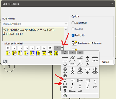

I am looking out for a way to include AIGDT symbols for CounterBore & Hole Depth within HoleNotes.Formatted Text.. I need the dimension to be shown as shown in image 1. I used StyleOverride command as suggested from various reference. But I could get only as shown in image 2. Below is my code. Can someone help me please.

Usually the best suggestion in complex drawing note formatting scenarios is to first do it manually, then reverse engineer it by accessing that existing manually created note, and inspecting its FormattedText, and maybe even copying its contents into the appropriate portion of your code.

Well, it doesn't work that way. These symbols will convert themselves into 'v' 'x' or 'n' when we copy paste. These are AIGDT font, but unfortunately we can't call for Styleoverride within the Hole callout

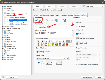

Hi @shunmuga_maheswaran.  If you are not able to create the hole note manually, then edit its text manually using the Format Text dialog to get it the way you want, then reverse engineer it by inspecting its HoleThreadNote.FormattedQuantityNote and HoleThreadNote.FormattedHoleThreadNote values afterwards by code, then I also have one other suggestion you could try.  You could either modify your current DimensionStyle, or create an alternate DimensionStyle, and change its settings for that specific hole note scenario to meet your needs, then simply apply that DimensionStyle to the HoleThreadNote when or after you create it by code (HoleThreadNote.Style).
DimensionStyle.GetHoleThreadNoteOptionValue
DimensionStyle.SetHoleThreadNoteOptionValue

For the first option, it doesn't copy as the way it shows. It copies like this.
"<QTYNOTE> v Ø<CBDIA> x <CBDPT>"
 That is the problem
Secondly, changing the dimension style is the best option I agree. I can set a new dimension style for that one hole so that doesn't affect other holes. I have some restriction to move away from company set standards and if someone wants to copy this code and work on his Inventor, this may fail. That is the reason I am looking for an inherent option within ilogic itself.

Hi @shunmuga_maheswaran.  We all want the solutions to our Inventor automation/customization challenges to be simple and easy, but unfortunately sometimes no simple or easy solution exists, or at least no one seems to know of one.  That is often the case when attempting to modify 'formatted text' in drawing annotations.  The manual dialogs for editing them often have tons of controls and settings built into them for helping us edit that type of stuff, but attempting to do the same things by code can be incredibly complex, and require way more code that it seems like it should.  If you only wanted to insert a couple special characters in a customized hole note once in a while, we could use the 'Edit Hole Note' dialog and the 'Insert Symbol' control, as seen in the screen captured image below.  However, if trying to do that entirely by code, we first need to retrieve the existing value of the 'FormattedHoleThreadNote' property, then edit that very long, complex looking String value by inserting something similar to the following:
"<StyleOverride Font='AIGDT' FontSize='0.254'>n</StyleOverride>"
...in the correct location(s), to insert the diameter symbol.  The 'Font' portion of that is obviously important, but the 'FontSize' spec is usually filled in based on the current/active DimensionStyle for that specific scenario of a HoleThreadNote, unless modified directly within the 'Edit Hole Note' dialog.  Some of those placeholder entities within the overall note, even though they may look very short & simple within the 'Edit Hole Note' dialog, there will be far longer and much more complex String within that one property behind the scenes for it, because things like precision, tolerance type, and tolerance precision, and alternate precisions are also being dictated within some of them.  This is why often the quickest way to get the exact String value you want to use within an iLogic rule is to do the edits manually, within the dialog, then get the value of that FormattedHoleThreadNote property afterwards, and copy it into the iLogic rule that is supposed to help repeat that step next time.  But just like in the 'Styles Editor' dialog when editing those styles for HoleThreadNotes, there is a long scrolling list of possible scenarios to choose from, and each would likely require a different custom formatted text String.
What I often do in situations like that, depending on the scope of the issue and/or how often it is required, is to create one or more alternate DimensionStyles (I have a list of them), where each DimensionStyle has different settings, for different situations.  Then whenever needed, either switch to one of the alternate styles before placing a new dimension annotation, or select one or more existing drawing annotations, then choose the alternate style on the Annotate tab's 'Format' panel, to switch them to that style later.
