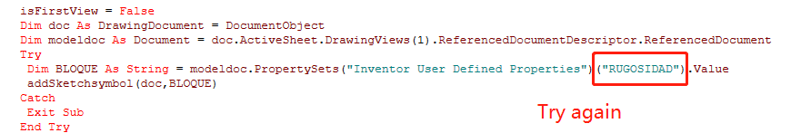

I sent you some images of the intention I have with the code, maybe you will understand me better
Message 10 of 16
yuzeaa
The information you provided in your previous post was incorrect.  Try it again with my last post

yuzeaa
Sorry, I didn't see clearly that you were using parameters. I will correct it and post it later.

				If DocumentObject.ActiveSheet.Size <> preSheetSize Then
					repositionsymbol(DocumentObject)
				End If
			Else If Context(1) = "EditDrawingBaseView" Then
				If isFirstView Then
					isFirstView = False
					Dim doc As DrawingDocument = DocumentObject
					Dim modeldoc As Document = doc.ActiveSheet.DrawingViews(1).ReferencedDocumentDescriptor.ReferencedDocument
					Try
					 Dim BLOQUE As String = modeldoc.ComponentDefinition.Parameters("RUGOSIDAD").Value
					 addSketchsymbol(doc,BLOQUE)
					Catch
					 Exit Sub
					End Try
				End If
			 End If
        End If
    End Sub
	Sub addSketchsymbol(oDrawDoc As DrawingDocument, blockname As String)
	   Dim oSheet As Sheet
       oSheet = oDrawDoc.ActiveSheet
	   Dim oSketchedSymbolDef As SketchedSymbolDefinition
       Try
	   oSketchedSymbolDef = oDrawDoc.SketchedSymbolDefinitions.Item(blockname)
	   Catch
	   Exit Sub
	   End Try
	   Dim oTG As TransientGeometry
       oTG = ThisApplication.TransientGeometry
	   oSketchedSymbol = oSheet.SketchedSymbols.Add(oSketchedSymbolDef, oTG.CreatePoint2d(17.5, 6.2))
	   oSketchedSymbol.Name = "FirstSketchSymbol"
	   repositionsymbol(oDrawDoc)
	End Sub
	Sub repositionsymbol(oDrawDoc As DrawingDocument)
	   Dim oSheet As Sheet
	   Dim SketchedSymbol As SketchedSymbol
	   Try
		   SketchedSymbol = oSheet.SketchedSymbols("FirstSketchSymbol")
	   Catch
		   Exit Sub
	   End Try
	   Select Case oSheet.Size
	       Case DrawingSheetSizeEnum.kA0DrawingSheetSize
			   SketchedSymbol.Position = oTG.CreatePoint2d(23.5, 6.2)
		   Case DrawingSheetSizeEnum.kA1DrawingSheetSize
			   SketchedSymbol.Position = oTG.CreatePoint2d(20.5, 6.2)
		   Case DrawingSheetSizeEnum.kA2DrawingSheetSize
			   SketchedSymbol.Position = oTG.CreatePoint2d(17.5, 6.2)
		   Case DrawingSheetSizeEnum.kA3DrawingSheetSize
			   SketchedSymbol.Position = oTG.CreatePoint2d(15.5, 6.2)
		   Case DrawingSheetSizeEnum.kA4DrawingSheetSize
			   SketchedSymbol.Position = oTG.CreatePoint2d(11.3, 6.2)
	   End Select
	End Sub
End Class
Message 13 of 16
Miguel.CarvajalS34Q6
I tried again and it still doesn't work, it can't insert blocks to the drawing sheet

Message 16 of 16
This code works well for me, I just can't get the value of the "item" ("general note ±1") to be a dynamic value that comes from the custom property iProperties.Value("Custom", "RUGOSIDAD") = RUGOSIDAD
and I also can't get the coordinate to insert the block to adjust according to the format in use
