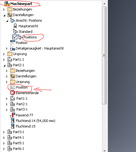

Hello
I need help with iLogic.
I have an assembly with other subassemblys, parts and virtual parts in it.
In the subassemblys are sketches without extrusion. The sketches are called "Positioning".
In the sketch are gemoetries from the Subassembly for a machine. I need them for a drawing.
With the code below, I create a new view (called "Positions") in the mainasssembly and set all parts in it invisible, if the assembly is named "Machinepart".
Now I need to set only the sketches in subassembly with the name "Positioning" as visible in the view "Positions".
For information, I am not a programmer! I found some of the code below and edited it. My programming skill is on basic. If then else... thats it.

Doesnt work. Sketch still not visible. And if no view exist with name Positions, an error occured.
In the Screenshot I show what I need.
Assembly is "Machinepart".
In every subassembly (Part1, Part2, Part3 and so on) is a sketch with name "Position".
My rule create the view "Position" if not exist and turn all Parts (1, 2, 3, ...) invisible.
The next step ist that the sketch "Position" have to be visible. But only the sketch. Not extrusions or anything else. Only the sketches with name "Positon" (arrow marker) in every part.

First I want to thank you for your help.
I think you have the same problem as I had? It isnt possible to catch the sketch direktly and turn it visible or invisible. Correct?
Because with the methode you made, I get the sketch. But all of it. The drawed lines and the projected geometries of the part.
If I turn the sketch manuelly visible, it only shows the drawn lines without projected geometries taken from the part.
Thats a problem for the machine. The machine doesnt understand different types of lines. Its all one type for it and would try to take them all.
Thats why I need only the drawn lines and why I made a extra sketch for it. 😕
Next problem. It doesnt take only "Position". It take all sketches in the subassembly without extrusion.
Position, Sketch2, Sketch3... in example.
Its annoying... 😞

As you can see on picture in post 5 we have two sketches in the subassembly.
Position and Bottero.
Only Position have to be visible. With the code your provided, both sketches are included.
