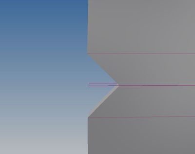

I need help creating an iLogic rule as I am no coder by any means. Our company uses small notches at the bend lines of our flat patterns, but sketching these in again and again are rather tedious. The ends reach out to the bend radius and 1/16" inward along the center of the bend.
I found a rule that is similar to what I need, but not quite. Any suggestions?

@chandra.shekar.g
Yes, I can provide the sheet metal part. The cut exists in the flat pattern. Thank you for your help!

@philip1009
Most often we create .dxf files from our flat patterns. We'll get the parts laser cut then folded. Problem is, some of our designs have been difficult to fold, so we have created notches at our bend lines to assist during the folding process which has benefited us well. As far as I know, Inventor doesn't provide this utility.

@GeorgK
Your method is close to what I need. Ideally, I need the points of the triangle to be constrained to the bend lines, which varies with the thickness of the material and its bend radius. Moreover, I could only get a single triangle to sketch, rather than for each end of the bend lines.

Aksedition
Same thing I need to create on bend lines of  flat pattern, but not able to do that. I want to add these notches on endpoint of every bend line when flat pattern created. Can anyone help to do that. I also attached part file of same.
