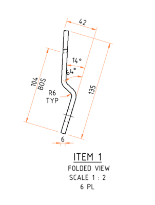

In an effort to automate some sheet metal drawings I've managed to write 2 snippets of code (found similar on forums, thanks legends) which firstly run within a part/assembly to set the home view to "work plane1" and secondly an update from drawing that allows me to run the part snipped from the drawing. This so far works well but I've struggled to find any examples of using iLogic to set a drawing view to "Home" on the view cube.
I also tried setting this to "Front view" but couldn't get the view cube in the drawing to match the view cube orientation in the part (Front (part) <> Front (drawing view)).
I've attached 2 images showing the before and after running the home view code and then manually setting the view cube to home.

GosponZ
i think i reply to fast. This is not rule that will move part.
