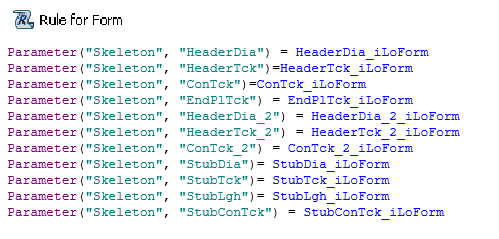

I'm curious why you seem to have two versions of every parameter.  One that seems like the original, and one with "_iLoForm" at the end of it.  Judging by the image in your previous post, you seem to be referencing a model file found within your Vault system.  And the original parameter's seem to be found within that, then you've created copies of all those parameters within the active assembly.  Are you attempting to 'drive' all those parameters within the referenced model by the local model's parameters?  Since I'm not currently working with Vault, I wouldn't really know how that interaction should function, so I wouldn't be able to offer any advice there.
   In your last post, within the rule named "Rule for Form", I assume this is just to push all those parameter values out to the referenced model file, right, and not intended to aid in firing the following rule named "PreSelect of ConTck"?  So, these rules should fire in the order they are listed within the document, unless otherwise specified.  If so, you've already pushed the value of both of those parameters out to the referenced model, without the value of "ConTck_iLoForm" having been changed by the third rule yet.  Perhaps adding a line of code to the end of that third rule that will do as it does in the second rule, and push its value out to the referencing model, after it has been changed would work for you (or vise versa).  You may also need to change the order the rules are running, but I'm not sure.  And if you don't need to maintain a multi-value list within the referenced model file, you could likely just eliminate the list preservation technique within my last posted code, and just set the value  directly.

BRLMCHKD
Hi W.Crihfield
Why I have two versions of the same parameter, when the only difference is the suffix _iLoForm?
The reason is, that I have a Skeleton part, where I control certain key parameters in my assembly
via a Form called ‘Rule for Form’ see inserted foto.
But I have now concluded that it is actually not such a good idea anyway, with the temporary
preselection in the MultiValueList. It is difficult to explain why, but I give it a try.
First I liked the idea that “ConTck” automatically adjusts when I changed on the value of “HeaderTck”
(because that’s how it will be, for the most part, in reality). But there may also be cases where I
change the “HeaderTck”, but where I still want the “ConTck” unchanged.
Therefore, it is actually not very appropriate to set up any rule for this anyway. As first assumed.
Sorry for the inconvenience I have caused, and Thanks for all the helpfulness. 🙂
