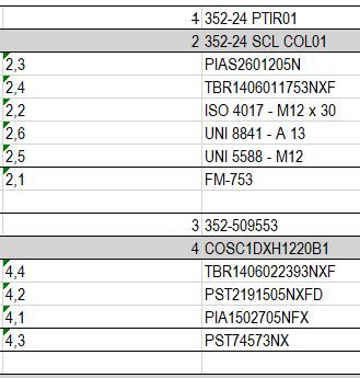

Hi everyone,
I'm trying to export the BOM to an Excel file with this rule,

but I can't reorder the list,
or rather within Inventor the list is sorted while in the Excel file it doesn't maintain the correct ordering,
how can I correct it?
I attach images to better understand the problem.

It looks like the Inventor doesn't change the content of BomRows collection. In this case you can implement your own ordering of bom rows. In this case I recommend you to implement your own Class which contains the information relevant for export (Line 67 - 74). Then you can create your collection of instances of this class (Line 3). Fill this flat list (Lines 9 - 39) and sort them when you write data to the Excel (Line 45).
Note: for some cases you need to improve the sorting. This is the simplest sorting by string. For more advanced sorting see this post.
This is not complete code, but only re-implementation of QueryBOMRowProperties method used in your original post. (Without Excel sheet formatting)

marco_bonacina5834P
Thanks for the reply, with this modification it works fine

HI,
I'm trying the rule but I can't get what I want with the sorting.
In practice, in Excel file, it does not maintain the numerical sequence from smallest to largest, for example the number 10 is inserted after the lines containing the numbers 1. Do you have any solution to this?
Thank you
Michael.Navara
This is what I'm talking about. You need to implement custom comparer which can handle this.

Full code is in attachment.
NOTE:
  • Fix for Excel conversion of strings to numbers dates etc. was added
  • Language independent search for Structured BOMView was added
  • Excel formatting is missing
marco_bonacina5834P
Now the sorting works but it doesn't fill in the quantities
marco_bonacina5834P
I solved it, there was a missing part of the code.
