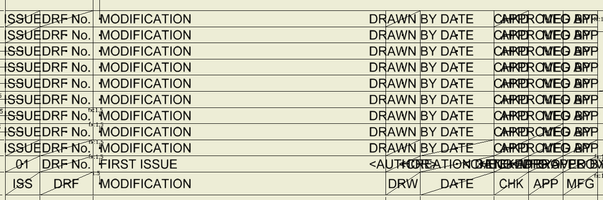

A.Acheson
Any Chance of showing images of what attributes your searching for and where there located. I don't have Inv 2023.
Regards
Alan

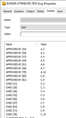

JelteDeJong
You could try something like this:
Dim doc As DrawingDocument = ThisDoc.Document
Dim sheet As Sheet = doc.ActiveSheet
Dim borderDef As BorderDefinition = sheet.Border.Definition
Dim reg As New Text.RegularExpressions.Regex("<Prompt ReadOnlyUniqueID='(\d+)'>([\s\S]+)<\/Prompt>")
For Each tb As Inventor.TextBox In borderDef.Sketch.TextBoxes
	If (Not tb.FormattedText.Contains("<Prompt")) Then Continue For
	Dim match = reg.Match(tb.FormattedText)
	Dim Name = String.Format("{1} ({0})", match.Groups.Item(1), match.Groups.Item(2))
	Dim result = sheet.Border.GetResultText(tb)
	iProperties.Value("Custom", Name) = result
Next

creggo
Hi @A.Acheson, the border definition properties, you can see the rev table area names are all the same.
creggo
Thank you @JelteDeJong! This works very well, all prompts are now iproperties, exactly what I was looking for.
