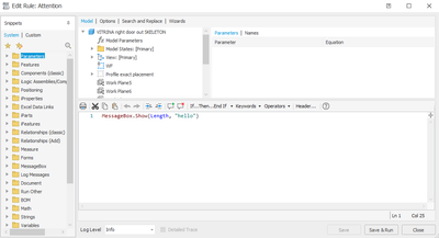

thank you! its not working:
when I try it this way:
its is working but the message title is what I wrote in the text and the message content is the value of the parameter "Length", like this:
and I want the title to be "Attention", the content to be "Hello", and not showing the Length value at all. its will be nice to add bottum like "yes" and "no" as well.
