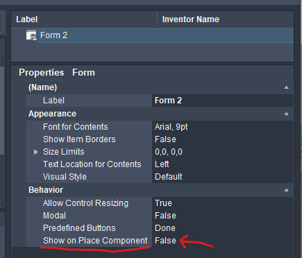

I created a form to trigger when I create a new part or open an existing part. However, when I place the part in an assembly, the form triggers.  In addition, when I open an assembly, the forms for every component in the assembly will trigger. In the form editor, show on place component is set to false. I have the form to trigger under new document and after open document in the part template. In the assembly template, I do not have any event triggers or forms set. Does anybody have insight on how to prevent the part forms from triggering in these situations?

You can try the one setting mentioned in the original post here, but that is not necessarily a guarantee, as you have seen.  While editing that Form, and you have the main/top node selected (for the whole form itself), then down within the Properties area, below the Behavior sub group, make sure the setting named "Show on Place Component' is set to False.
Beyond that, I assume it is showing because you have something it in the Event Triggers dialog.  Every time you place an assembly component occurrence into an assembly, that also 'initializes' the Document associated with that File, and adds that File/Document reference to the parent assembly.  Initializing a Document is similar to opening it, but not visibly, but it only loads a portion of its data into Inventor's session memory, instead of all of its data.  So, that action will trigger the On Open event.
