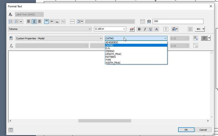

I am trying to write an iLogic that inputs the "Pattern" custom iProperty into the view label and turns it on. If the Pattern iProperty is not found, I want it to not change the label, turn off the label visibility, and move on to the next view. I want it linked to the iProperty rather than just the value because I don't want people to have to run the iLogic all over again if the pattern letter changes on one of the parts.
The issue I am having is this: The code works just fine when every view on the drawing has the Pattern custom iProperty. However, when the first placed view (or maybe any view, I'm not sure) does not have this custom property, the code selects the wrong custom property on all the views that have the custom property and also turns off the view label on those views.
It seems that when the code can't find the "PATTERN" iProperty, it selects a different one and then doesn't look for the "PATTERN" iProperty on the following iterations, but I'm not sure why this would happen.
What am I doing wrong?
Here is my code:

After running the code, all the views have their view labels hidden, and this in the view label text:
This is a list of the custom iProperties in the view that doesn't have "PATTERN":
This is a list of our custom iProperties in the views that do have "PATTERN":

JelteDeJong
There are some things wrong with your formatted text. try this:

Matthew_Policelli
Hello, and thanks for the reply 🙂
I tried your code and it still does not change the label to the correct parameter. This time it changes it to this:
To try to figure out what was happening, I added two message boxes to the code to compare the "text" string and the formatted text of the view label after it is set to = text:
MsgBox(text,Title:="Text String Value")  						'<-------- check text string value
        oView.Label.FormattedText = text
MsgBox(oView.Label.FormattedText,Title:="Label Formatted Text")    '<-------- check label value
Here are the results:
As you can see, even though the code sets the formatted text of the label to equal the text string, they aren't equal.
Is this a bug? It doesn't seem to be an issue with the code.
Matthew_Policelli
The only way I can get it to work is to temporarily add the custom iproperty to files that don't have it, and then delete it at the end of the code. This may be a bit of a roundabout method but it works. However, is there a way for me to have it turn off alerts for read only files? (so have it add the iproperty for read only and then delete the pattern without asking if I want to change it or check it out from vault?)
