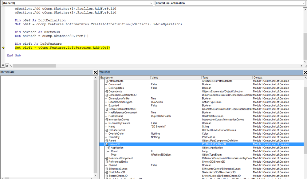

Hi @jason_snyder,
Downloaded the attachment and opened part called "LOFTED_PART_1.ipt"
For some reason, sketch3D which is derived from assembly is not having "Profile3D" as shown in below image.
So, unable to create loft feature using 2dsketch and 3d sketch. which are derived from assembly.
Thanks and regards,
CHANDRA SHEKAR G
Developer Advocate
Autodesk Developer Network

Hi @jason_snyder,
No changes required for VBA code. Again, Sketch3D of centerline looks complex for Inventor API and unable to create profile3D for it.
Sub CenterLineLoftCreation()
    Dim oDoc As PartDocument
    Set oDoc = ThisApplication.ActiveDocument
    Dim oComp As PartComponentDefinition
    Set oComp = oDoc.ComponentDefinition
    Dim oSections As ObjectCollection
    Set oSections = ThisApplication.TransientObjects.CreateObjectCollection
    oSections.Add oComp.Sketches(1).Profiles.AddForSolid
    oSections.Add oComp.Sketches(2).Profiles.AddForSolid
    Dim oDef As LoftDefinition
    Set oDef = oComp.Features.LoftFeatures.CreateLoftDefinition(oSections, kJoinOperation)
    oDef.Centerline = oComp.Sketches3D.Item(1).Profiles3D.AddOpen
    Dim oLoft As LoftFeature
    Set oLoft = oComp.Features.LoftFeatures.Add(oDef)
End Sub
