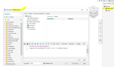

It's because of this, that I would recommend splitting this into 2 rules.
Generally when I have a Show Form rule, it only shows the form... and I usually put an Update line above the showform line, just so that the model is in the expected state when the form is presented.
Such as this
Then I would have another rule that has the other code:
Note that the form buttons can dictate when things update too, but if you split the rule into 2 rules, I don't think it will matter in this case.
And another thing you could do, is set the form to have no Predefined buttons, and then use your rule as the Update/Ok button.
I hope this helps.
