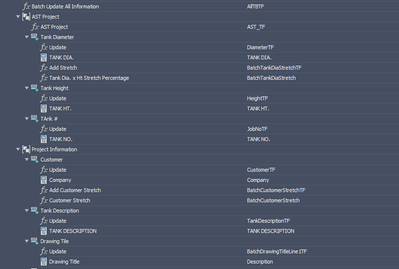

Forms is very frustrating to work with however this one issue takes the cake. I created a tab on a form, added a group control then added rows with everything working fine. Decided I did not need the group control and would put the Rev Block variables for row one of the table in a row on the form. Now there is a large space between the rows that I can't remove. Delete the tab, add a new tab and the problem is still there.  How do I fix this?

Can you share the edit page of the form? These are kind of a mine field and we would need to see how you constructed, then replicate to offer alternate solutions.

Here is the edit page. If I put a group box with no content under the last row everything looks good (second image). The blank space is the size of the group box when it is removed.

Adding a blank space at the end should do the trick.

That worked. Thank you for the help.
Another quick question on the same topic. What is the trick to get all of the fields on the card to align close together? It seems like they have a mind of their own and align or not. The project information group looks ok but not ideal while the AST project group is not aligned.
Thanks again.
mat_hijs
Try the same thing, add a blank space at the end of the row.
