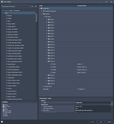

I think I encountered a bug while creating an iLogic form. I'm trying to make 20 columns with 4 rows of data.
At first I tried to make 4 rows and then have the 20 fields in these rows.
This was the result in the form editor:
But when I opened it afterwards it looked like this:
Then I tried making 20 groups, each with 4 fields, and place these in one row.
The form editor looks like this, so I don't think I did anything weird to cause this:
Has anyone else ever seen this behavior or is this just me?

JMGunner
If you have more then 15 Group in row and Group
you need too put row in the same level at Forms
se picture 1
@mat_hijs
Best Regards JM
I can create the same "error" pciture2

JMGunner
No one has problably
tried that combination
20 groups after each other and row
when i removed the upper group (iproperties) the
form also worked
it's workaround
@mat_hijs
Best JM

MjDeck
Hi @mat_hijs - it's not by design. It's probably a bug. There can be problems when you have a large number of controls in a single row. Have you found a successful workaround?
Which version of Inventor are you using? Can you post a sample part?
In the long term, we should add a Grid layout element to the form designer.

MjDeck
@mgrenier1 - I think you are seeing a different problem than the original poster. The issue you are seeing looks like internal number INVGEN-83398.
You can probably work around it and get the rows to stay together by adding an Empty Space (Espace Vide) at the end of each group. The Empty Space should be within the group, but not within the last row. It should be the last thing in the group.

MjDeck
Sorry, my mistake. Instead of adding an Empty Space in each group, please try adding a single Empty Space at the bottom of the form (outside of any group).
