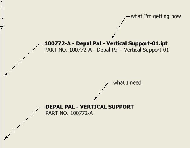

I am trying to add some custom labels in our assemblies. Th e fabrication shop prefers to have them labeled this way rather than regular ballons.
Ideally you could just click on the part and and it adds the part name and number to the leader. I noticed in the format text box you can see the part number and name in function box. I was going to pull the text from there and then split the string into pieces. I have quantity on there too but I don't need to automate that.
My coding skills aren't quite up to par so any help is appreciated.Untitled.jpg

Thanks. That got me most of the way there. I just need to manipulate the text a bit more. Trim the part number and ".ipt" off, make the name uppercase. Also I will need to trim the part number so it's just a number. Untitled.jpg

Here's what I got so far, and it appears to be working. Still needs a few more tweaks to handle revision numbers and multiple part numbers.
