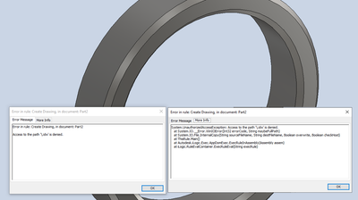

Hello, I'm completly new and still trying to learn iLogic and coding in general.
I have code that makes a drawing of my open part/assembly, which I found here: https://clintbrown.co.uk/2018/10/07/automatic-drawings-with-ilogic/
I've edited the code to match my file locations and template names, but I'm getting a error that I can't understand.
File Locations:
The code I'm using (with minor edits as explained above).

Message 2 of 14
Based on your error, the issue is here. One of your paths is invalid
System.IO.File.Copy(oCopyFiler,oNewFiler,(True))
Your oCopyFilers looks fine from what I can see, but oNewFiler is based on iproperties. Do your iproperties contain any invalid characters for a file path?  Also you looks like you are copying an .idw to a .dwg, but I'm not sure if that is an issue or not.

ChristianAndersenIsmyname
Now the message box appears, but still getting the same "path '\.idw' is denied."
Message 12 of 14
So the problem is coming from
oWrite.WriteLine(oFilePather & iProperties.Value("Project", "Part Number") & ".idw")
 oNewFiler equals "\.idw" because both oFilePather and iProperties.Value("Project", "Part Number") equal nothing so "/.idw" is all that's left.
oFilePather comes from
oFilePather = ThisDoc.Path & "\"
Which means ThisDoc.Path is returning nothing. I'm not sure why, but it could be as @WCrihfield mentioned and it's because the document hasn't been saved yet so it has no permanent path.
iProperties.Value("Project", "Part Number") is empty because you haven't assigned your document a Part Number in the Project tab in iProperties
