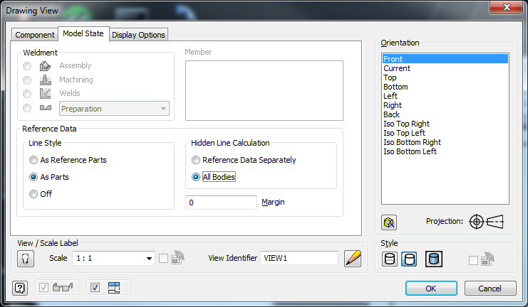

I've now Saved the Document by doing a SaveAs instead as I can actually figure out how to do this, and once I open this document shortly after the SaveAs my rules trigger. So everything seems to being flowing as I want it to unless there is a better way of coding it.
All I need now is to figure out how to get those 4 options set in the view

MjDeck
Mitch,
 About the options to create the view initially:
The Level of Detail will be taken directly from your model document.  If you activate the LOD that you want before running the rule, that's the LOD that will be shown in the drawing views.
 You can add the View Representation name to the function to create the base view:
oBaseView = oSheet.DrawingViews.AddBaseView(oPartDoc,oPoint1, 3/16,kFrontViewOrientation, kHiddenLineDrawingViewStyle, "Default")
It looks like the API doesn't provide a way to specify the options for reference components when you create a view:
Line Style = "As Parts"
Hidden Line Calculation = "All Bodies"
