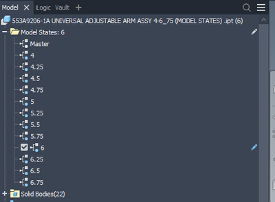

I need some help with iLogic. I have an assembly where 8 of the 10 parts are driven by Multi-Body Model State. The source Multi-Body part has multiple Model States with various sizes. I would like to have a form in the Assembly where the user enters the Model state that they want their assembly to corresponding to.
From my basic understanding of iLogic, we want the iLogic rule to open all the  8 individual components and change the Multi State to what the user entered in the form. With the help from the post below, I was able to run external rules where the code goes to the individual components and changes the model state. The difficulty I'm having is where I want to incorporate the Form function with user input for the Model State. Currently I'm opening the source code and manually changing the Multi-State name, I would like to change this so the users don't mess around the source code and just uses the Form to change between the Model States.

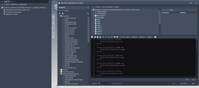

@JhoelForshav thanks for the code. It seems to work for most of my components in my assembly, however I am running into an issue with it doing anything for one of my components. The component that uses the "Worm_Gear_Design" multi-value property isn't changing model states at the assembly level. It is built the same method as the other components that do work correctly, so I'm at a loss on why this component is giving me an issue.
I put a green check mark next to the components in the browser tree and parameters that are working with the code within the assembly. I put a red X next to the component and parameter that is not working with the code despite it being configured exactly the same way as the other two components that are working fine.
Here is the code of yours that I modified....

iLogic, Parameters, and Model State for the components...
This component works....
This component also works....
Yet is the one that is not working for some reason....
Any help me figure out the issue would be greatly appreciated!!
