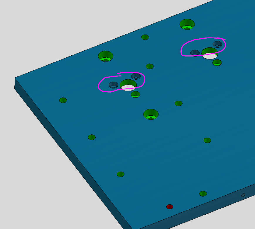

I changed the rule to select all holes and if it finds holes with diameters 3, 4, 5, 6, 8, 10, 12 then it sets the tolerances to H7. In addition, I had to introduce protection before choosing a threaded hole.
I managed and the rule works - unfortunately not quite 🙂
Can you explain to me why it omits holes with diameters of 3, 6 and 12mm ??
code below after my modifications:

I have two additional question and it's possible that someone will be so kind and explain it to me 🙂
1. What is it "generic_diffuse" in line :
Dim color2 As ColorAssetValue = App2.Item("generic_diffuse")
I guess this is some "property" of the assets.add method when it comes to the LocalType parameter (in this case for "GENERIC" screenshot below) but I can't find anything in the API help (I may be looking wrong)
2. I also have a problem to color the holes made with Pattern Components (the first is ok but the rest is in the default color - screen below). You can lead me to solve this problem. I think you need to check if the pattern component has holes and what. Then color all of the pattern component feature in the color of the first occurrence. Unfortunately, I don't know how to go about it 😐
Thanks in advance,
Regards,
ralfmj
